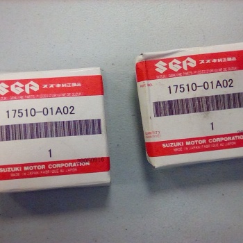

I got lucky... i managed to buy a new shaft.... £120
But will have to find a bike shop to press it into the clutch cover...
Happy days..

PostPosted: Sat Oct 09, 2021 12:11 pm    Post subject: Reply with quote
Good to see you had some luck Paul. Your picture suggests that the part is actually an 'assembly'...which may explain why it costs so much!
Is it possible to dismantle the assembly? More specifically, could you have dismantled your existing assembly, made a new shaft and put it back together again?
To install the new assembly, could it be pushed in by hand if the cover is heated in an oven (or perhaps even by a hot air gun)?

Iv still not fitted it yet...
Iv got a engineer friend who is going to use a press to fit it...
And iv also ordered another shaft as a spare...
Robinsons suzuki only had 4 water pump shafts for sale and iv bought 2 of them......
