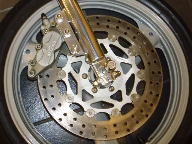

A nice ride out and good to see some interesting bikes, so now it must be time to take it apart again. I've been messing about with brake discs and calipers for a while now and making little progress. Decided when I got home that the best way was to get the fork leg and wheel out so I can see what's what on the bench.
So that's it in bits. Out of curiosity rather than obsession I thought I'd weigh the old solid disc and the "new" 298mm floating rotor...
So that's a decent weight saving and an improvement in braking. I've mentioned the weight of the bike, and my own weight, on here before. It's got to be easier for me to loose 250g than it is to take that amount off the bike, but the saving's there soI'l take it!
That's as things should go together. The 298mm disc runs in the center of the caliper. The top caliper bolt picks up on the standard mounting point, with the botomone nicely between the upper and lower standard pick points. I'll make a plate and spacer to join it all together, just need a nice piece of hard alloy plate out of the scrap bin at work.
I think James said the 298mm discs were from a 3MA, I need to confirm that before I try to get hold of one.

Thanks to good old eBay I've got some H30 alloy strip and bar, and a selection of stainless fasteners. After a bit of messing about I've got my first attempt at a bracket and spacer for the Brembo caliper.
I don't have a milling machine, and I don't think the super-crisp CNC machined look would work with the SDR so it's drilling, filing and cutting by hand and then a quick rough polish with wet'n'dry to get something like. The bottom bolt is counter-sunk, and I need to go and see a mate to cut that.
It all seems to hang together OK, and doesn't look too in-your-face which was always a priority. If it works I'll do a better job of the polishing.
It's really hard trying to photograph shiny things, it looks much better in the dim light of my garage than laid bare in the brigh flash of the camera... Embarassed
