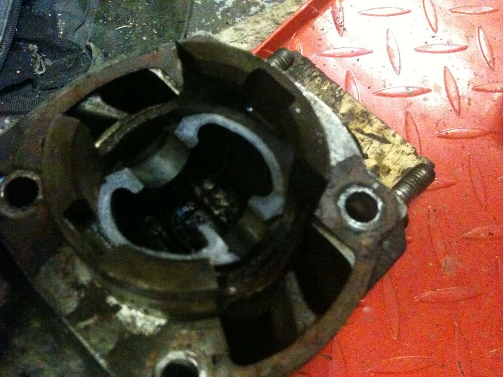

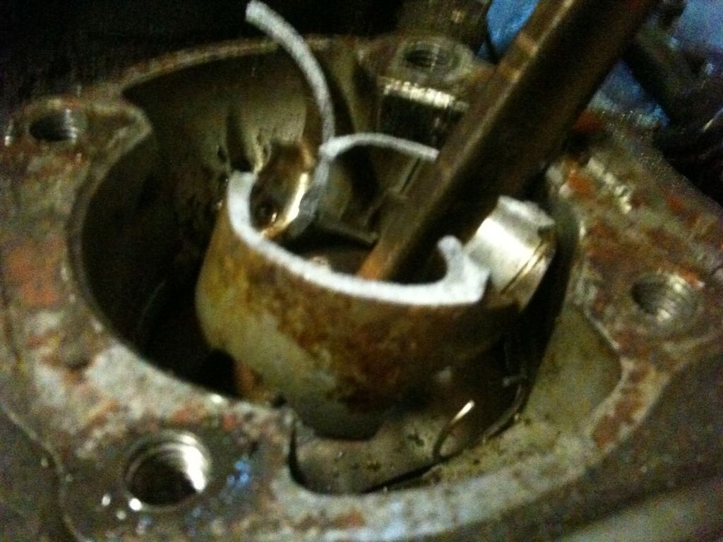

Well the good news is that the crank is now free.
The not so good news is that the lhs piston is a new multi-piece component.
A full engine re-build will now have to occur....
More pics to follow...

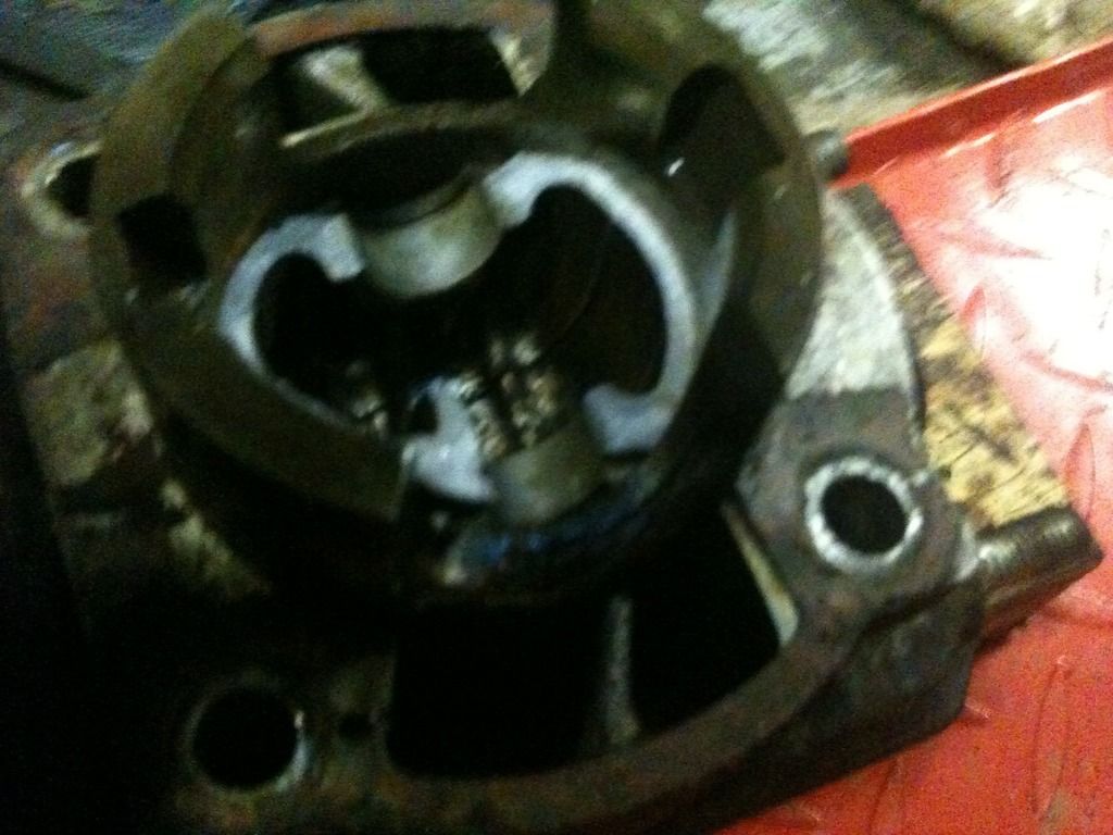

I had finally got the piston to move a few mm down, this got it to BDC or almost.
So then I put pressure on the crank nut and it gave an almighty crack..
The rest was still stuck in the bore
Cal
Joined: 20 Dec 2012
Posts: 62
Location: Bristol
PostPosted: Wed Apr 08, 2015 8:49 pm    Post subject: Reply with quote
Rod and small end, look at that wear, it looks better in my photo's than in real life
Looking down the bore
From the bottom

PostPosted: Wed Apr 08, 2015 9:13 pm    Post subject: Reply with quote
So with a bit of brute force it came out.
Multi part piston
Sing this corrosion to me...
Bore score? DOES ANY ONE RECKON THAT IT WILL HONE OUT?
Cal
Joined: 20 Dec 2012
Posts: 62
Location: Bristol
PostPosted: Wed Apr 08, 2015 9:16 pm    Post subject: Reply with quote
It will hone out no worries
So it will need a full engine re-build.

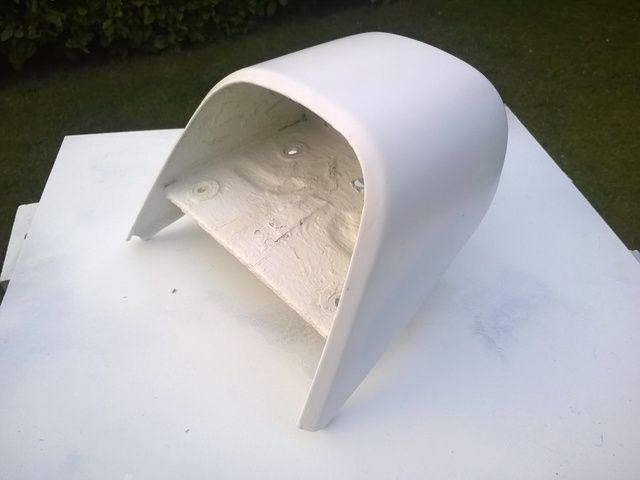

Makes my bit of filling and painting look pretty poor...
It'll take more filler and more paint to get something I can get away with, even for my rat bike.
