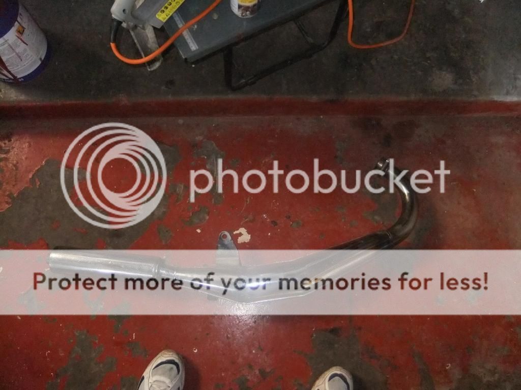

had a good look in the garage and cellar area.
found the following
[img]
forgot i had a micron for the AR in really good nick- but if i remember back in didn't fuel correctly.
the new parts been stored for a few years - bought from Z- power.
[/img]

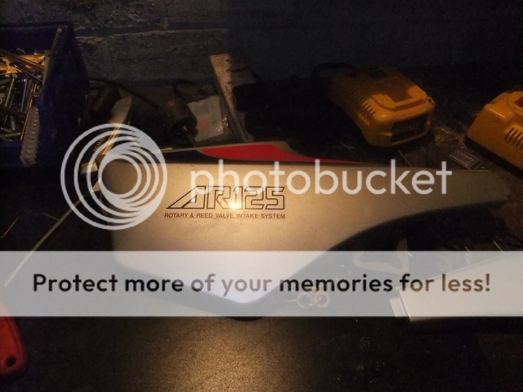

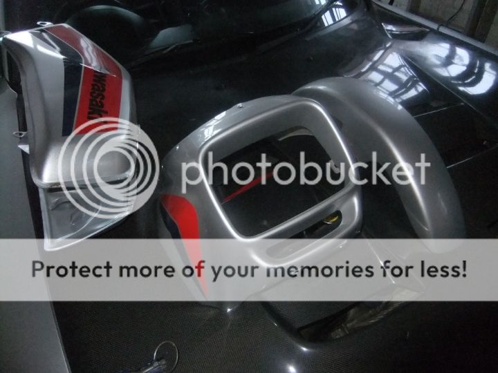

a bonus was finding a really good side panel
i have another but that needs painted and new transfers, deal with that later

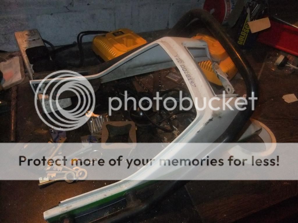

bad news have a back cowling but wrong colour and broken- need to think about that one.

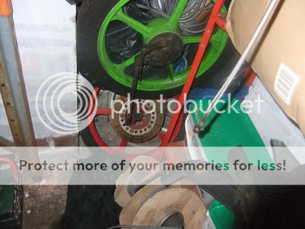

yes there is another 3 wheels all different colours.

Well you will definitely generate funds with the wheels!

Great stuff !
You did really well finding the NOS tank and headlight fairing.. That alone would make me want to keep original colour scheme ...and almost all the early ARs are white and red.. With silver versions being almost extinct in good condition.
I think I've got some silver side panels (but I will need to look, may not be any better than yours..) you never know they could be new Wink
I also have the silver headlight fairing ... But unfortunately not a NOS tail fairing in Silver.. So that will need some searching out or matching up. At least the painter should be able to get a good match if that's what's needed. White ones are a right tw@t as the new panels naturally discolour with age..
I'm sure I have a new tail flap and lock set, again will have to search them out. May even have the gold decal for the flap Wink
I'm happy to help people do their ARs as long as they don't just break them or sell them straight away (been disappointed in the past a few times when I've given new parts away only to see the bikes get sold on for a profit ...grrrr)

It was both a stroke of brilliance.. and also a real shame KHI made the restricted AR such a difficult machine (for a spotty teenager in the 80s) to properly de-restrict.
When others where just opening power valves and removing exhaust washers.. To get an A model AR.. the B needed a host of upgrades.
Of course in restricted trim, the B was probably the fastest learner 125 you could buy, a proper sized bike with good suspension and brakes.
I'm biased of course.. But it's really not hard to get good power out of the B model if you know what your doing. Easily making it as quick as the RD/RG/MBX of the day.
The micron was only really designed for the B model. I can give you the jetting to make it work better if that's the exhaust you choose to use. You can also shorten the stinger in the end pipe to make it work better with the A model spec ..
Finding a good Mk1 A model exhaust can be a massive challenge if you don't have one. I have a friend who may be able to help with one that looks almost identical to the KHI version though with better power.
Really looking forward to the rebuild. Ask away and I will do what I can to help ok

PostPosted: Sat Jan 10, 2015 8:39 pm    Post subject: Reply with quote
Engine rebuild - I don't know anyone in Scotland
Furthest north I would trust is Mick Abbey based in Harrogate
He used to trade out of a garage at the side of a pub (Knox Inn) but he has moved to another unit. The website has the address and his mobile listed.
http://mickabbeytuning.co.uk/
Like you, I'm not bothered about 'balls out' tuning nowadays.. Not for general road use anyway. But then again I have the whole spectrum with my bikes, mild to total grenade..lol
As long as they are sympathetically tuned to a stage not too far from A model they run reliably for years. It's the candle burning brighter for half as long again.

thinking ahead on the Wheels.
i have a front gold one (which is the color i want).
and a red rear and green rear. anybody want to swap?
Could i transform one of these into the gold finish by painting.
My local powdercoater can't get the factory finish !!.
He just wants to paint them all gold, nothing like OEM.
