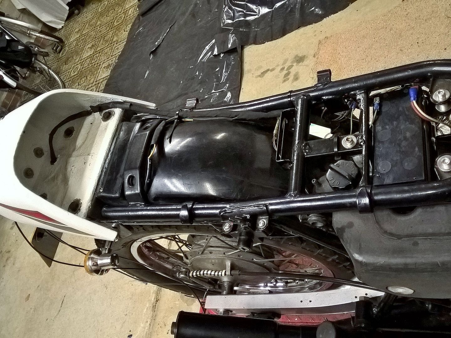

Made a start on the electrics, starting at the back with the easy bits.
I've now got a working tail light, brake light, flasher unit, rear indicators, neutral light and and indicator repeater.
Quite happy with that for the evening.
