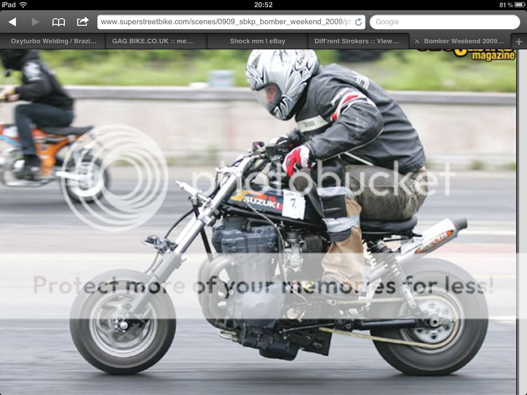

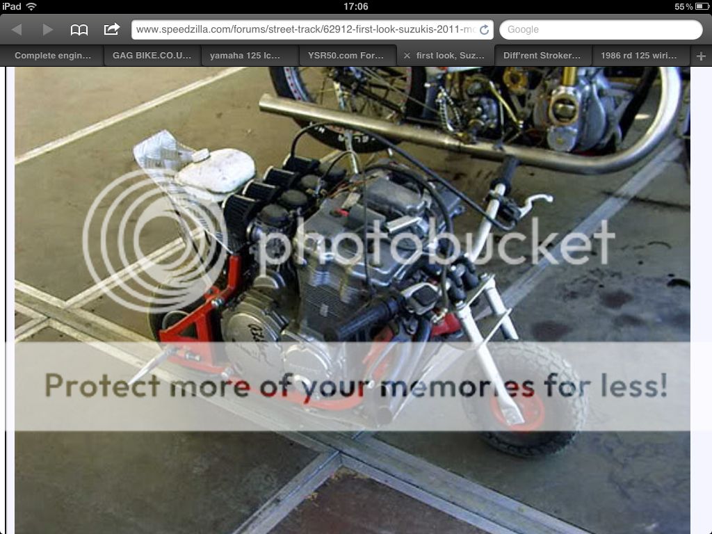

PostPosted: Thu Mar 12, 2015 8:45 pm    Post subject: Reply with quote
Is this turning into the woefully inappropriate upgrades thread?
PostPosted: Thu Mar 12, 2015 8:47 pm    Post subject: Reply with quote
Or even this?
Both get my approval i like little bikes with big engines!
PostPosted: Thu Mar 12, 2015 9:46 pm    Post subject: Reply with quote
Certainly made me smile! Very Happy

PostPosted: Fri Mar 13, 2015 6:38 pm    Post subject: Reply with quote
Looks like the bottom one is actually a trike?
PostPosted: Fri Mar 13, 2015 8:02 pm    Post subject: Reply with quote
I dont think id stay on it long enough to need to worry about how long a rear tyre lasts! On the plus side i bet you never need a front tyre, it will never be on the floor!
