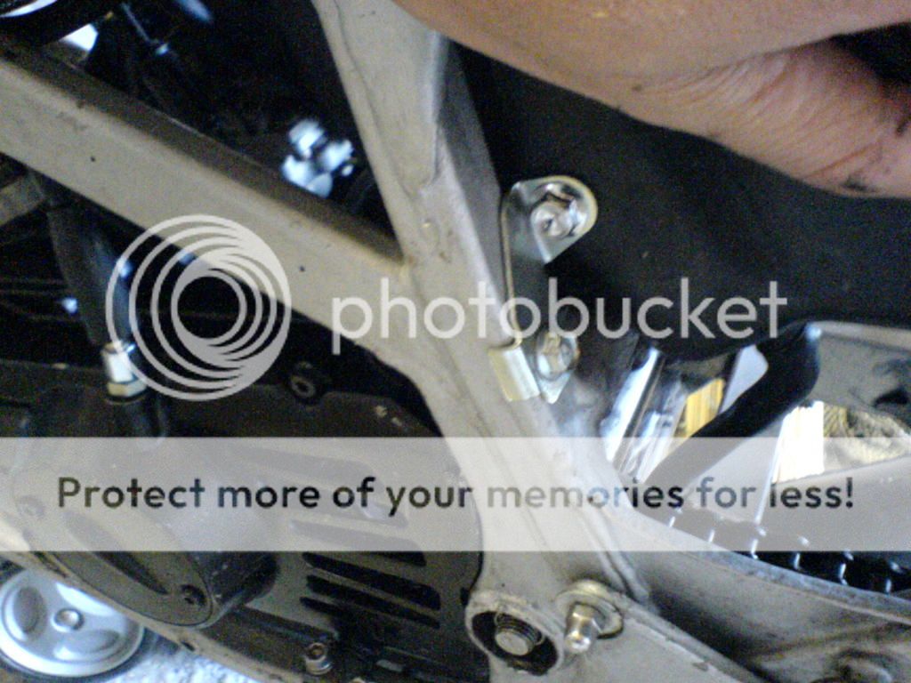

Another part i need is the airbox bracket, i have the right hand side.
but need other side.

Hi all
Had a bit of luck with airbox brackets , now have both side brand new..

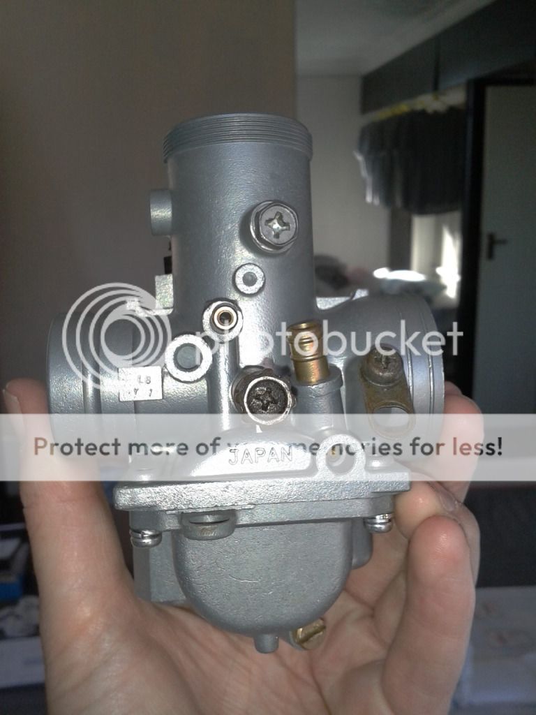

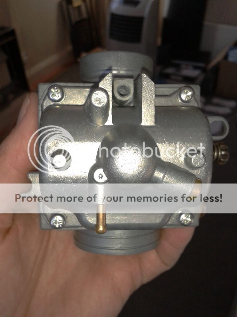

Look at the carb now ,
This is the company i used.
PostPosted: Sun Sep 30, 2012 12:09 pm    Post subject: Reply with quote
Looking better than new there fella

PostPosted: Thu Oct 04, 2012 8:06 pm    Post subject: Reply with quote
Wow that looks almost as good as new....
