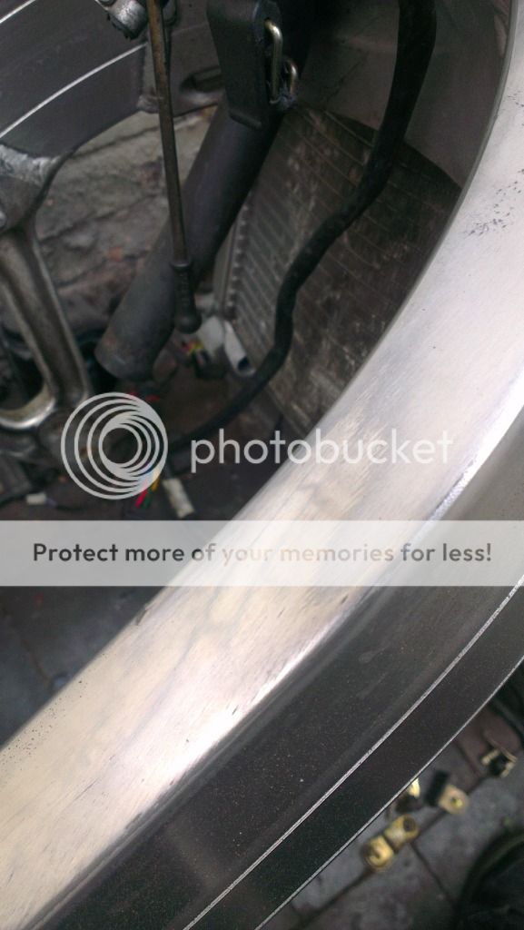

at first I was having trouble getting the protective "alodine" coating off the frame..
after a few hours trawling the net and pulling my hair out trying to buff through it, I finally stumbled upon a little secret which took the frame from this..
to this..
I wasn't sure if I wanted to go all out bling with the polishing on the frame atleast for now so I finished it off with a brush finish using a uni-direction sanding method..

still having some issues removing this streaking from the polished finish, but for now it's back in the bike awaiting everything else to get her built up before i give all the shiny bits their final buff..

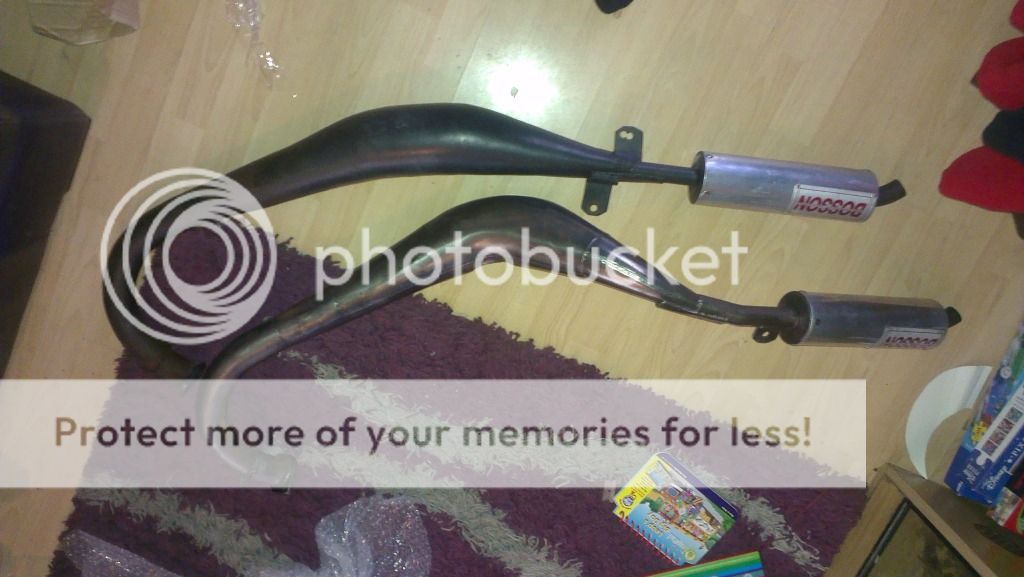

also managed to grab a set of micron gp-style pipes to go along with the project.. these are in really good condition for their age..
the stingers were looking a little bit worse for wear though, and i'd spotted a few exhaust stickers I liked on ebay so I decided to trace them and get them mocked up alongside giving the end cans a bit of a rub down and polish up to get them back to a more satisfactory finish..
and both of them finished along with their period micron stickers applied..

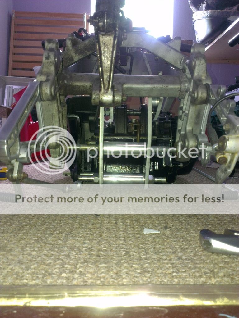

after occupying myself with some more polishing lol I then pulled the front end out of the bike and brought it upstairs in order to test fit the motor in the frame in the warmth of the house
she's not sitting 100% straight here.. I fired the swingarm in and took a few measurements making sure I was happy with the alignment of the engine in the frame.. getting the motor sitting where it needed to be... took alot of sweat, tears, tea and swearing but I finally got there in the end! and the bike went of to get the mounts welded to the frame and each other where appropriate..
after more swearing, hammering, blood and more tears this is how she sits now..

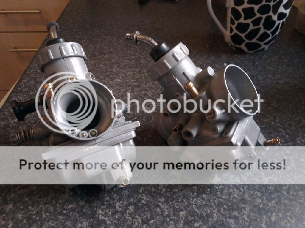

spent a few hours cleaning and building the carbs back up.. now sitting like this

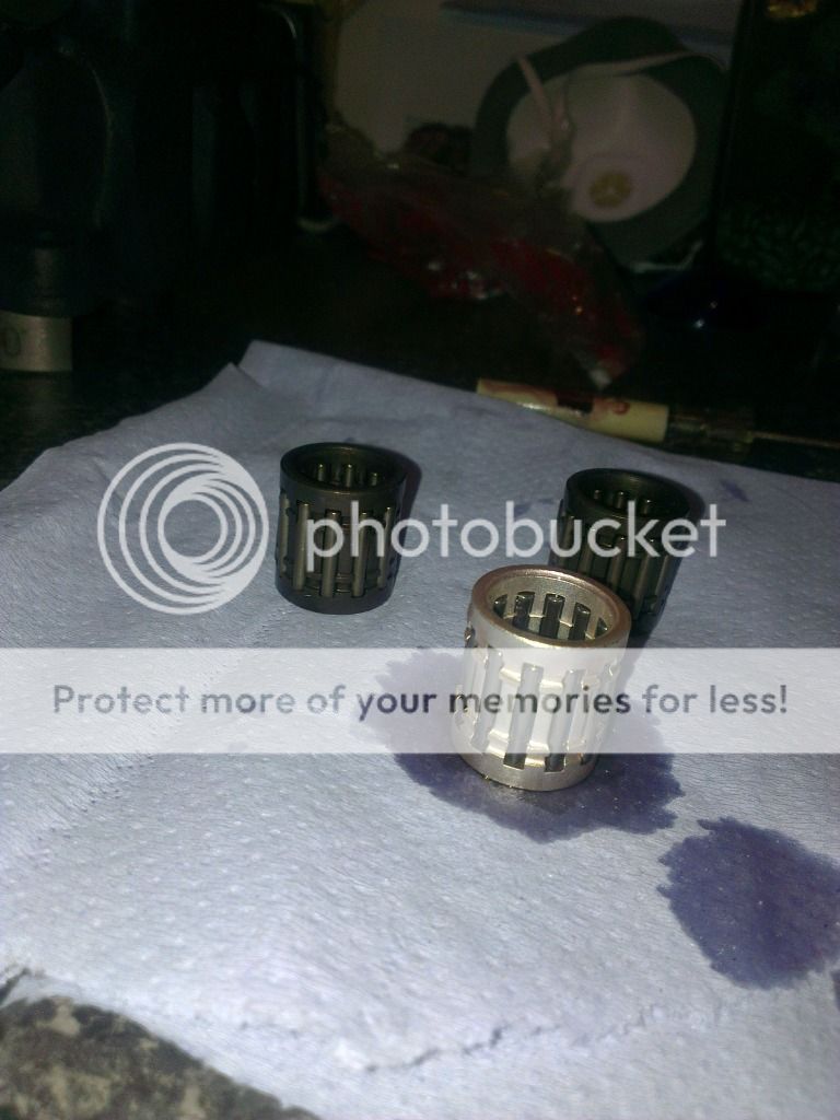

though and behold i have forgot to order bloody circlips and small end bearings, so have to wait for these to come in now!  |

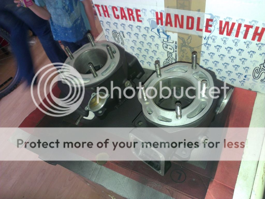

Started lapping the barrels and head yesterday evening and prepping the barrels and head for paint..
Before and after..
And stripping the paint of the head.. What a nightmare, nitromors is properly crap these days so its taking a lot of attacking with scotchbrites Aswell as nitromors and other paint a strippers on the head..
This is her atm.. Still more work to do..

the new vs old small ends..
pistons in and circlipped..

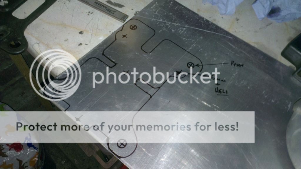

Made up a bracket for the coils today.. cheers to Sam for the materials required
All mounted up.

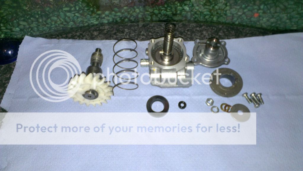

pulled the oil pump apart today, seems to be in good enough order of service..

but on the plus side it gives an additional inch of ground clearance compared to the micron gp pipes and also these are much much lighter.. still not as nice a fit as I would like..
But can hardly complain for the price of them.. and I should be able to make a wee profit on the micron gp pipes aswell
Exhausts are now for sale again.. going a different route with them..

Wee bracket to hold the pv controller and cdi in the making..
Finished making up bracket for the pv servo and cdi.. neatly contained under the seat..
Covered in metal.. and bogging.. but think it will do the job nicely..

stripped and rebuilt the carbs again today, as the slides felt a bit gritty.. having been aware that these had been soda blasted prior to coming to me I ultrasonically cleaned them, and cleaned with again afterwards with some carb cleaner down all the passages and airways..
Anyway after pulling them off the bike and starting into them, I blew the carb cleaner up through one of the carb oil feed inlets and low and behold.. a mountain of the blast media shot up out of it into the carb. Thank god i'd the sense to clean them a 2nd time to ensure they were no longer contaminated.. that would have done some serious damage to the barrel, head and throttle slide..
unfortunately my phone camera hasn't been working since I received it back from being repaired so no photos.. I couldn't quite believe the amount of crap stuck down there..
Anyway they are back in the bike, the throttle is now run up and adjusted.. going to have to get the finger out shortly and get back into the wiring.. I think one more full night should hopefully finish or atleast put another good sized dent in it anyway

also after rebuilding the oil pump myself and not being 100% happy with the action of the piston, I sent it to be looked at by a guy called "arrow"/gary that knows these pumps well.. It came back like a new pin.. not worth the risk in my book.. being happy that i gave it a go myself.. but having a second opinion gave me piece of mind..
