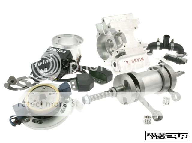

Theres also the likes of pm tuning that do alot of bolt on goodies, they do a top end for the am6 engine found in the rs50 and others that has the potential to push 20bhp!
And the 125 tuning is even crazier, there is another company that sell a kit to space out your existing crancases and put another cylinder in! Two stroke tuning is thankfully very much alive and getting more and more mental! _________________ Gagging for it |

About 3500 euros though!
But if you used that on a 20 bhp 50cc set up you must be looking at a 30bhp plus moped, and if you had that set up on a 30bhp 183 moped you would be looking at at least a 50bhp scooter! _________________ Gagging for it |
