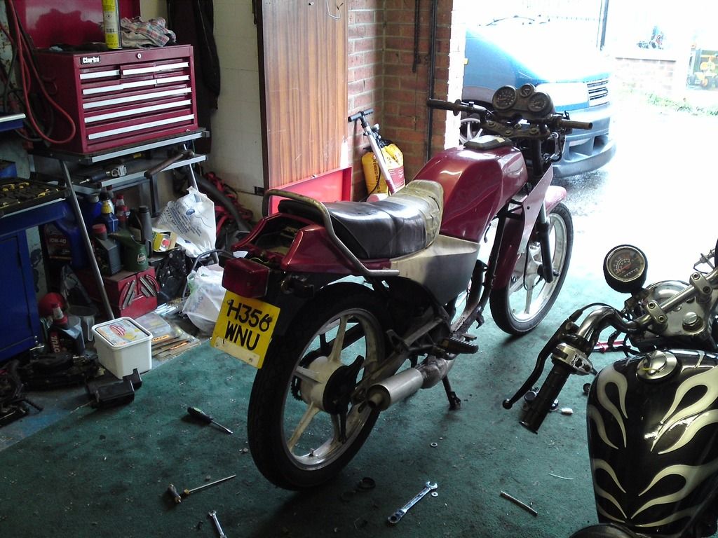

i got this a little while bike after the wheels were put on another ar
it had been stripped abit or in some cases bodged
old pics i found of it long before i got it (i found then on the web)
somone had bodged a set of kh125 clocks onto and said it had been off the road since the early 2000's due to overheating
after that it was bought by the previous owner then sat in a shed for a while in pretty much the same state although he did get it running
then later is how i got it after the wheels and exhaust were gone but i did get it for a decent price
and one the way home
when i got it home i managed to get the engine to splutter not bad for been sitting for a while also there was a mouse nest under the carb
i ended up kinda nicking the engine to for the a1 while i sorted mine out ended up doing 900 miles not bad with 105psi compression and a dodgy kickstart lol

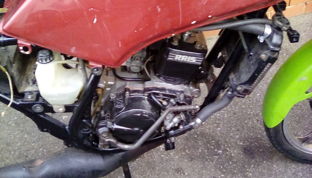

PostPosted: Sat Mar 19, 2016 6:06 pm    Post subject: Reply with quote
so a little while after getting the b7 i got a kh125 k7 (12v Wink ) which had a nice set of sport rims (and better forks) so fitted them on the b7 (the kh came with a spare bike with good wheels so it was all ok haha)
so the topend of the engine
the engine was in good shape just needed a set of rings (piston was ok be replaced) some gaskets as the base was made from a pub menu lol a clutch basket and finaly a shim on kickstart

well... ermmm?
explains why it was loosing power rapidly
mains were like new still
melted/knacked seals

PostPosted: Sat Mar 19, 2016 6:37 pm    Post subject: Reply with quote
well up to date now
sprayed the topend and built it up (150psi compression)
runs ok needs alittle more work lol
