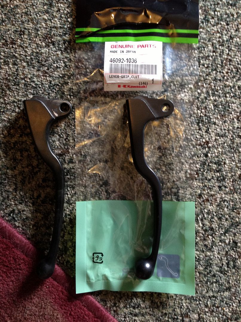

Most aftermarket AR125 clutch levers are NOT the same as the genuine Kawasaki item, even when they are listed with the kawasaki part number.
Picture below, genuine lever is centre under the kawasaki part number label, the aftermarket version (Velo) is on the left.
You should see a difference in the shape where its supposed to clear the switchgear .. Aftermarket lever hits the switchgear limiting the amount of travel. Not good and many a young teenager would have thought the clutch was not clearing properly changing gear when it was the lever.
Genuine Kawasaki part number for lever is 46092-1036, less than a tenner delivered almost next day by Cradley.
